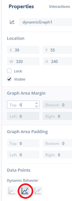

Good, Please note that just clearing the static graph doesnt reset the horizontal plotting. You must also reset X coordinate value and start increasing it again from 0 to 200 (if your X range is 0-200).
If you need constantly scrolling curve, then dynamic graph is right choice. Select scroll as dynamic behavior:
then just simply add points like
	dynamicGraph1.addDataPoint(some_value);
and graph-widget will place it to first free position (and also scrolls the curve if it is full).
So with dynamic graph you dont have to worry about X values. Naturally using dynamicGraph requires that the x interval of the data points is constant, otherwise the graph will be distorted in the direction of the X-axis.
Br JTP

Maybe slow down process bit, now its adding points maybe 30 times / sec. Also divide counter when using as x coordinate, in your version x- value is running out of screen in few seconds, I guess.
tickCounter++;
HardwareValues.TickCounter = tickCounter; // for debugging
if (tickCounter % 60 == 0)	// Insert each second tick
	if(SettingsValues.RadioButtonSelectedItem == 1)
		graph1.addDataPoint(tickCounter/60, 20/*DisplayValues.Speed*/);
And also clear tickCounter when radiobutton is pressed.
Basically your simplified tickHandler- code seems to work in 4.23.2 simulator and also STM32U5DK2 target.
Br JTP
