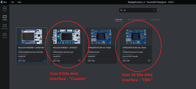

You can create projects using the H5 boards.
Some uses FMC 8 bits with custom interface, others uses FMC 16 bits with FMC interface :
You could get inspired by those and look if they have something different than yours.

The STM32H573I-DK_EXT-FLASH (the second from the left) that is using 8 bits data and custom interface is using the same driver as you.

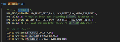

And This is the screen used in the application, according to the file TouchGFXHAL.cpp :
You can find the TouchGFXHAL.cpp file in the project folder path ProjectName\TouchGFX\target\.

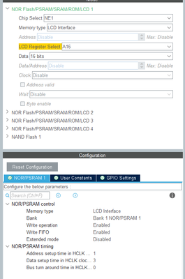

To give you a little more detail on how I'm able to communicate with the display using the FMC without using TouchGFX, I've got the FMC setup like so:
Specifically, i'm using 16 bit mode.

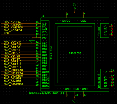

My hardware connections are as follows:
