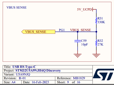

Hi @nico23
Did you check the pin used for vbus sensing in your software.  According to schematics, it is connected to PG1

FBL
Hi @nico23
Best regards,
FBL
