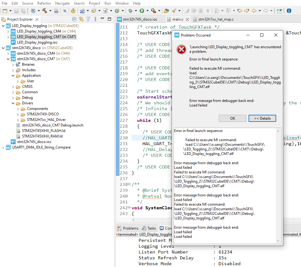

‎2023-04-26 12:17 AM
I am having this problem, has anyone found a solution to this?
‎2023-04-26 6:14 AM
Same question, same answer. You probably have QNX IDE installed. Remove its environment variables from PATH and environment. especially MAKE, LIB, INC and so on.
‎2023-04-26 6:19 AM - edited ‎2023-11-20 9:22 AM
@pavel A.​ Actually not! I have only STM32Cube IDE installed. No other IDE exist!
‎2023-04-26 6:23 AM
Then you have a different problem. The debugger has started, but failed to load the .elf file. This can be because of several reasons. Could you open a new question, please?
