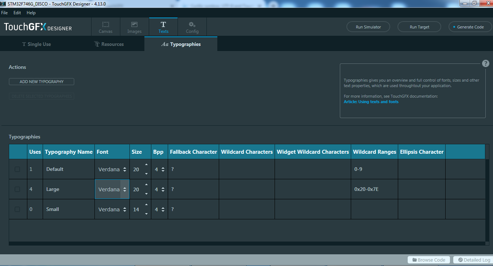

Hello, I from Russia and I use cyrillic symbols.
In touchGFX Designer I use cyrillyc symbols without problems.
But if I type cyrillic symbols in IDE, in codefiles
Mytext="Cyrillic_Text";
I get "?????????" on touchGFX gadget.
I try to translate codefiles to UTF-8 - same result: "?????????"
How to solve this problem?

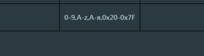

Did you set Text ->Typography-> WildCard ranges as below for textArea1Buffer ?
Hope this helps..
Karan
EEuge
Senior
No.
This is my options. Without any effect

DKlyu.1
I work with Cyrillic as follows
touchgfx::Unicode::UnicodeChar buffer[100];
    Unicode::fromUTF8((const uint8_t*)"тек�?т", buffer, 100);
    btn.setWildcard(buffer);
