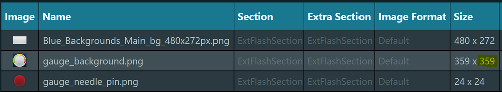

Gauge application working directly from touchgfx but not working when trying to run it through STM32CubeIDE. Please help to solve this issue

There were a few problems in your project.
First, the assets of the gauge were not the right size. You have a screen 480*272 and you want to fit a picture 359*359. Not possible.
Second, the AT is 24bpp but the painter used for the gauge was a Painter565 which makes the application crashed. Did you try to run the simulator ? Because it was explicitly mentioned. Therefore I changed the painter to Painter888 (look at the variables in Gauge.hpp).
