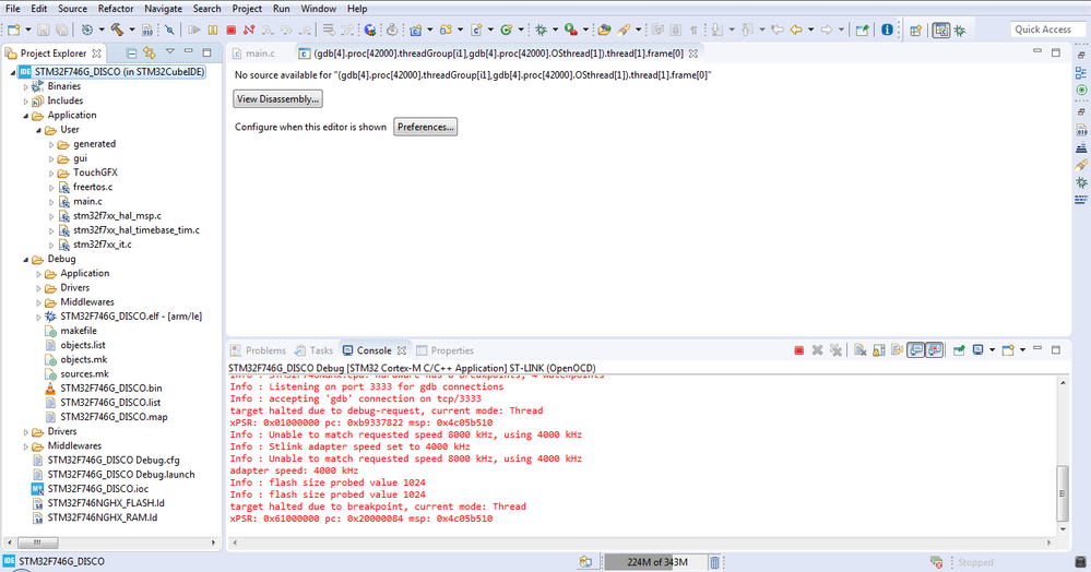

‎2020-04-17 9:45 AM
When I tried this debug halts and not enabling Resume button.
Following is the debug console data:
Open On-Chip Debugger 0.10.0+dev-00022-g02bea1f (2020-01-08-09:31)
Licensed under GNU GPL v2
For bug reports, read
http://openocd.org/doc/doxygen/bugs.html
srst_only separate srst_nogate srst_open_drain connect_assert_srst
Info : The selected transport took over low-level target control. The results might differ compared to plain JTAG/SWD
adapter speed: 8000 kHz
adapter_nsrst_delay: 100
Info : Listening on port 6666 for tcl connections
Info : Listening on port 4444 for telnet connections
Info : clock speed 8000 kHz
Info : STLINK v2.1 JTAG v35 API v2 M26 VID 0x0483 PID 0x374B
Info : using stlink api v2
Info : Target voltage: 3.206275
Info : Unable to match requested speed 8000 kHz, using 4000 kHz
Info : Stlink adapter speed set to 4000 kHz
Warn : Silicon bug: single stepping will enter pending exception handler!
Info : STM32F746NGHx.cpu: hardware has 8 breakpoints, 4 watchpoints
Info : Listening on port 3333 for gdb connections
Info : accepting 'gdb' connection on tcp/3333
target halted due to debug-request, current mode: Thread
xPSR: 0x01000000 pc: 0xb9337822 msp: 0x4c05b510
adapter speed: 4000 kHz
Info : flash size probed value 1024
target halted due to breakpoint, current mode: Thread
xPSR: 0x61000000 pc: 0x20000084 msp: 0x4c05b510
It suppose to enable Resume button (F8) but nothing happens even after 10 minutes.
Do you have any video tutorial for this?

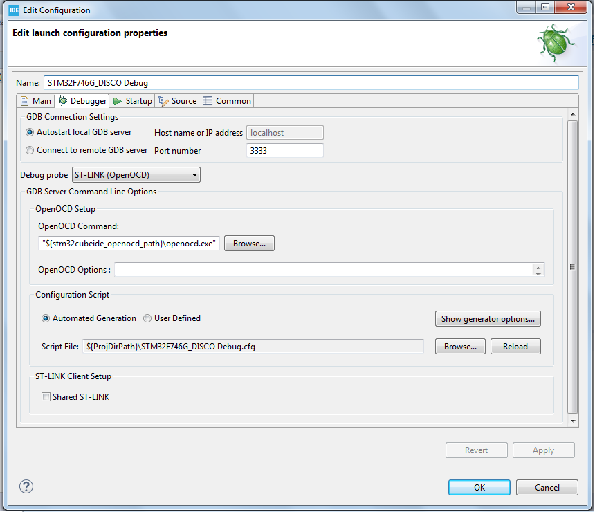

‎2020-04-20 1:26 AM
It looks like you can build the project correctly but you cannot download the binary file and debug (correct me if I'm wrong). It seems to me that it's a problem related to your ST-Link or your launch configuration.
Can you check your launch configuration (right-click on project > Properties > Run/Debug settings > Edit) ?
/Alexandre
‎2020-04-20 3:12 AM
This is my debug setting.
This setting works with my other projects.

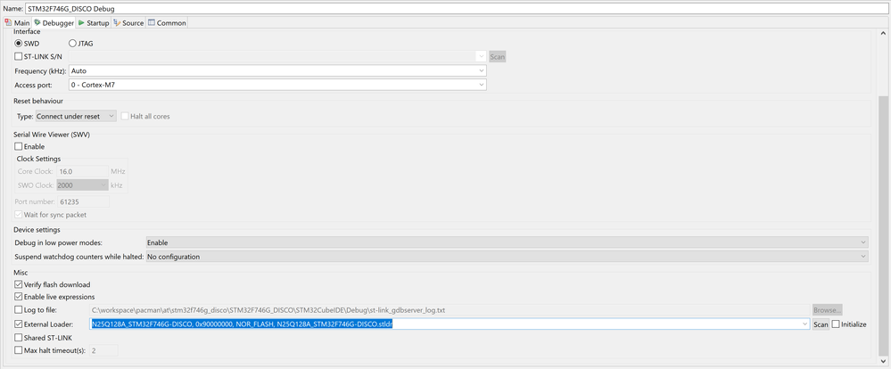

‎2020-04-20 3:47 AM
The Debug probe should be ST-LINK (ST-LINK GDB server) and then enable external loader and select the correct one as shown below.
You can also uncheck "Verify Flash Download" to accelerate the download process.
