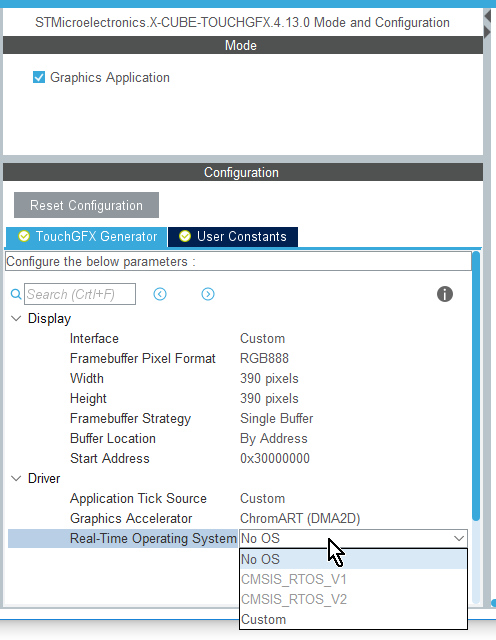

Starting from a CubeIDE project and adding TouchGFX, is it possible to integrate TouchGFX without FreeRTOS?
Note: I am using STM32F746-DISCO

Hi @JDant.1​,
Simply choose "No OS" when selecting an operating system in TouchGFX Generator, and be sure to not enable FreeRTOS in CubeMX view of course.
And read this for tips on working with TouchGFX and no RTOS: https://support.touchgfx.com/docs/basic-concepts/operating-system
/Martin
