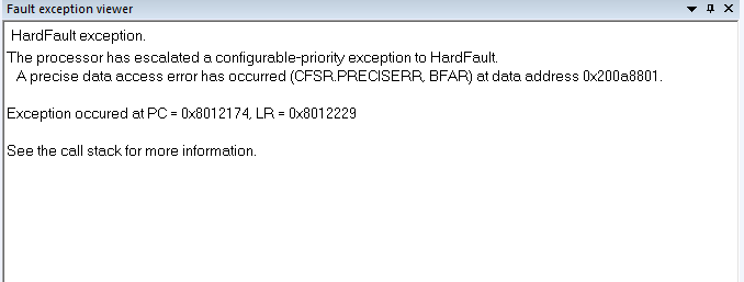

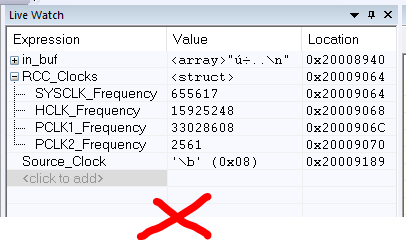

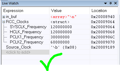

I'm using IAR Embedded Workbench IDE & STM32F207xx with TFT LCD Display, I configured the SysCLK to 120Mhz & HCLK to 120MHz & PCLK1 to 30MHz & PCLK2 to 60MHz, When I debug or execute program all frequencies change automatically to the random values and the HardFault exception execute.
how I know when the problems come

I think the scrambling of those clock values and the hardfault are both symptoms of the same thing: Your program crashing.
You might be able to get some information about the crash from what's reported by the fault exception viewer - for example is 0x08012174 a valid address in your program code?

In addition to Danish, you seem to have a starting point:
> Precise data access error at 0x200A8801
Cross check the map file (if necessary, re-build to create one), and observe the variable/data at this location in the debugger.
It is an odd address, so perhaps an unaligned access.

0x08012174 is a valid address, but the problems don't always give me the same address, each time gives me addresses differents.
I'm using STM32F207GZ, so the frequency can up to 120MHz, & I reconfigure it at 16MHz but always the same problems.
the program crash when I run the program, but if I debug it step by step, it will not crash.

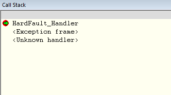

my question is when the program give address of HardFault what can i do??

The actual message text "has escalated a configurable-priority exception to Hardfault" sounds like your problem is in or with an interrupt handler.

Please how can I get the problem where is exactly, same function or something in IAR Systems can I get the last instruction where the crash is up

‎2019-10-16 3:41 AM
Difficult to say without the actual hardware and code.
But I would first identify the interrupt handler routine causing the issue, and review it.
Perhaps instrumenting or modifying the code.
