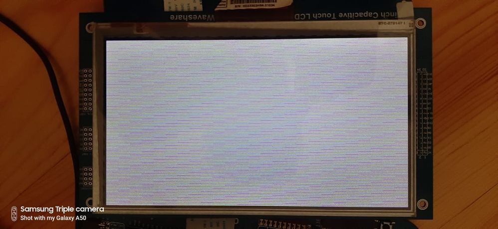

GMano.1
Hai...,
I am also facing same problem.
STM32F746IG (waveshare Development board) with 7 inch display.
I done every thing @HP​ (Community Member)​ but still have a same problem.
pLayerCfg.FBStartAdress = (uint32_t) & Image_data_image_Text; it work fine.
But if i change bellow address.
pLayerCfg.FBStartAdress = 0xD0000000; not working display image below (i am using bank2 so that use this Frame Buffer Start Address).
What are cause of this issuse?
Can you inspect that memory? Is anything actually being drawn? Maybe the display is showing the correct content (garbage).
TouchGFX HAL will set up the start address of the LTDC layer automatically based on what you set up TouchGFX with, so you shouldn't need to do this.
Can you show me your TouchGFX Configuration? If TouchGFX does not know about this address as the framebuffer address it won't render anything to it.
