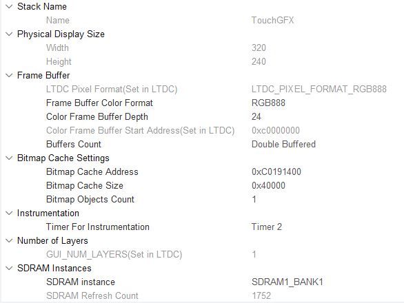

i try to start application on STM32F7 with external RAM.
I setup frame buffer and cache in external RAM, but touchgfx not loading screen to FrameBuffer, Cache is loading.
I check if image will render when a set start address of cache and FrameBuffer the same and it worked.
What may be source of the problem?

I configured everything in CubeMX and make screen in TouchGFX. Compiling with Atollic TrueStudio. I have little time to finish project so i try bitmap cache which i need.0690X00000ApO07QAF.jpg0690X00000ApNzxQAF.jpg
Also i add
    Bitmap::clearCache();
    Bitmap::cacheAll();
in touchgfx_init()

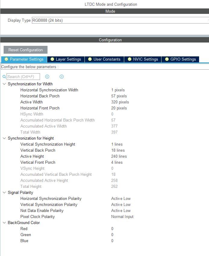

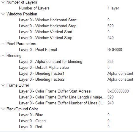

By LTDC configuration i also mean timings / porch settings - Do you have that right as per the display datasheet? is 0xc0000000 also set as the start address for touchgfx in the generated code? Is touchgfx configured to use LCD24 as its display driver? (given the RGB888 configuration ?
Your blending factors should be Alpha constant x Pixel Alpha, but that's not the cause of your issues.
/Martin

  • By LTDC configuration i also mean timings / porch settings - Do you have that right as per the display datasheet?
YES
  • is 0xc0000000 also set as the start address for touchgfx in the generated code?
YES

I can set LTDC background color and see it on display. I also (for test purpose) set Color Frame Buffer Start Address and Bitmap Cache Address to the same value 0xC0000000 (start address of SDRAM) and got the desired image on display. Therefore i asume that display and SDRAM are working. Image was cached to SDRAM.
