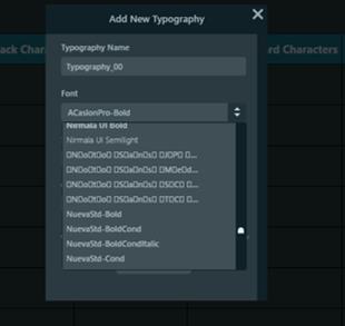

I encounter the issue with font appears differently in the old and new version of touchGFX.
The font I use : Noto Sans Medium.
In the old version (4.10) the Noto Sans Medium looks thin and tall
At the same time, typography name for Noto Sans Medium family is weird, see pic below.
In the new version (4.12) the Noto Sans Medium looks thicker, no problem with name display.
Now we kind of sure the thicker one is the correct one, but we want an explanation, what caused this difference?

Hi Devin,
TouchGFX 4.13.0 is out. Can you please check that? I know we've fixed issues related to this.

Hi Matin,
Just checked with GFX 4.13, same thickness as the 4.12 version.
So it just the 4.10 version appears weird.
/Devin
So, would you say 4.13.0 fixed the issue? :)
Yes, or the 4.12 version has fixed the issue already.
