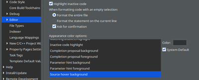

>allow you to achieve a maximum white background for all windows except the one where you edit the code.
afair this is from system default , somewhere (!) you can change this to custom color...but i dont remember now, was searching some time for this.
...like this:

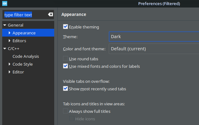

Have you tried to switch the Colors and font theme as "Default"?
I tried it. Here are the default values.
A small clarification: I want the colors to look like they do on Windows.

did you try basic color setting, not dark (as i have) , but light ...?
...like this:
