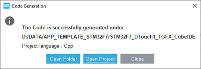

- Generate code for CubeIDE ("Generate under root" checked as with unchecked it gave me the following error (https://community.st.com/t5/stm32-mcus-touchgfx-and-gui/touchgfx-designer-error-quot-unable-to-locate-c-lt-path-to/td-p/100242)
- Open the generated "ApplicationTemplate.touchgfx.part" file with TouchGFX Designer

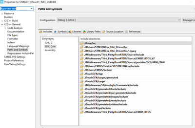

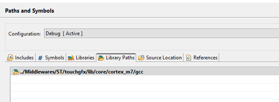

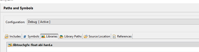

I've managed to build the project comparing the CubeIDE setup with one generated from a ST demoboard.
CubeMX doesn't automatically include in the CubeIDE project the TouchGFX "Libraries" and the "Library Paths" that must be set manually.
These options can be found under (right click on the project)-> Properties ->C/C++ General -> Path and Symbols

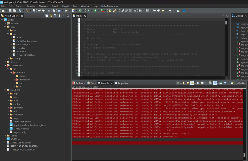

Sep 18, 2024 10:02 PM UTC
I'm facing the same issues and I'm a bit new to STM32.
Can you please help me to add library and library path? What should I add there?
Thank you in advance
