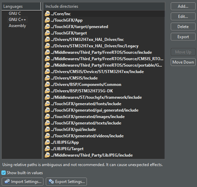

Make sure the project's Include Path points to the HAL include directory.
If auto-generated and not copied over at that time, use your file manager to copy over from the Cube directory to the project's.
2024-07-11 7:42 AM
Yes, my projects include path points to the STM32H7xx_HAL_Driver/Inc... Is there any other file that I might be missing ?
2024-07-11 9:34 AM
If that is a localized copy of STM32H7xx_HAL_Driver/Inc then you'll want to copy the file it's complaining is missing from the primary repository, wherever you have that situated.
\STM32Cube\Repository\STM32Cube_FW_F7_V1.17.1\Drivers\STM32F7xx_HAL_Driver\Inc\stm32f7xx_hal_ltdc.h
It's complaining about this one file, is it present, or not? If not copy it over, and check if it complains about any others.
I'd half expect stm32f7xx_hal_ltdc_ex.h to be missing too

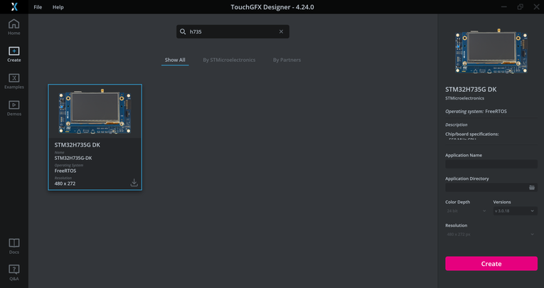

So, you select the STM32H735G-DK from the TouchGFX designer and create a project:
STM32H735G-DK TouchGFX Board Setup

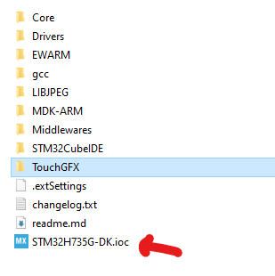

You navigate to one previous level of your TouchGFX project directory, and open the .ioc file using STM32CubeMX:
.ioc file

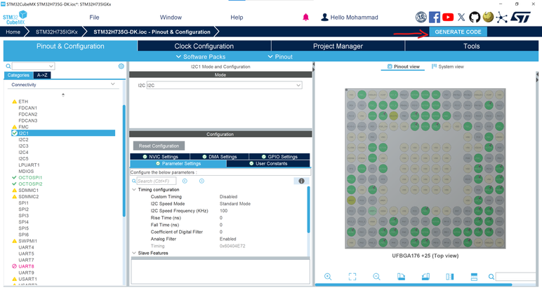

Then, you enable I2C1 and press Generate Code:
Enabling I2C and generating code
After that, you need to regenerate code from TouchGFX as well, and then you should be able to compile the project from STM32CubeIDE without any errors.
