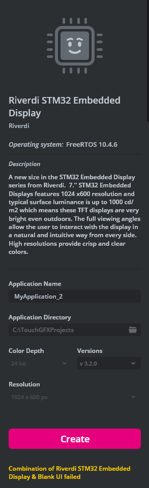

I simply wanted to create a new TouchGFX project for Riverdi STM32 Embedded Display.  It gave me "Combination of Riverdi STM32 Embedded Display & Blank UI failed" error all the time.
I've tried uninstall the legacy versions and re-install, but no luck.

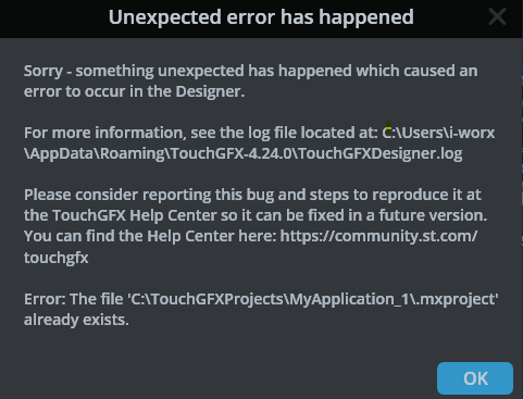

Update:
Please see error log attached.
Update:
  • Tried on another Win10 machine.  Same error.
  • Tried to re-install "VC_redist.x64".  Same error.
Update:
  • 4.23.0 gave the same error.
  • 4.22.0 and .1 work just fine.

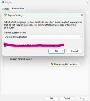

Update:
V4.22.0 and .1 gave failure while code generation:
C:/TouchGFX/4.22.0/env/MinGW/msys/1.0/Ruby30-x64/lib/ruby/3.0.0/win32/registry.rb:910:in `encode': U+7F51 to IBM437 in conversion from UTF-16LE to UTF-8 to IBM437 (Encoding::UndefinedConversionError)
Above checkbox fixed the encoding error.
Update:
The above checkbox fixed the V4.24.0 project creation error, but it gives me target failure during running on target.

The checkbox resolved the project creation error.
Running on target error might need to be discussed and resolved in other threads.

Hello @Eric Z. ,
Based on the error, it seems like you are trying to create a project in a directory that was previously used.
Could you please create a project in a different directory? (the path should not contain spaces)
And also, could you please try different projects? I wonder if it is specific to the Riverdi TBS or not
Thank you
Mohammad MORADI
Hi Madrac, thanks for your reply. Indeed, it's not related to a specific board. Hope ST can fix this soon.
Hi Mohammad,
Thanks for your reply.  I've tried using different directories with different names without spaces, but no luck.  I've tried other boards, and find that all of the partner boards give the error.  Other ST boards work fine. Hope this could rule out some factors.
