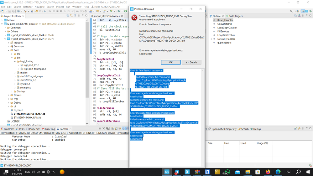

I create interfaces using the TouchGFX application and export them to CubeIDE. However, when attempting to upload the file to the microcontroller, an error occurs, even though the TouchGFX application can upload files successfully.

2024-10-09 4:23 AM
Linked to this thread:
https://community.st.com/t5/stm32-mcus-products/stm32h745-microcontroller-not-responding/td-p/729306
But same question: are you sure your are configuring the Power mode in SMPS and not in LDO config?
2024-10-09 4:23 AM
