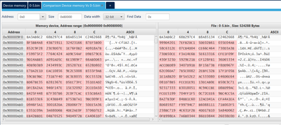

Thanks for your replay. When I verified the flash by the STM32CubeProgrammer, I got the the data dismatched.
Data mismatch found at address 0x90004400 (byte = 0xF8 instead of 0x8C)

I have moved the function to an application. And it can run successfully. However, when I tested it as a stldr, it failed to verify with a bigger size file (500K).
The error message is Error: Data mismatch found at address 0x90000A00 (byte = 0xA8 instead of 0x01)

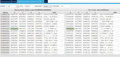

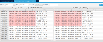

I compared the file with the memory as below. The wrong section address is from 0x9000_0A00 to 0x9005_F5FF.
The first error data is 0x8F5BB4A8, which can be found in the bin file while the address is 0x9006_2800 rather than 0x9000_0A00.
So it seems some blocks data were wrotten to wrong place. Howerver, accroding to the serial port output, there is not error or wrong operations during downloanding. May I know how can fix it? Thanks.
