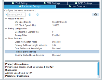

I am trying do a loopback test, i.e I2C1 as master and I2C2 as slave on the same board(STM32F429ZI DISC1).
I am giving the address for slave as 0x42 left shifted by one, and storing the same in oar1 register for I2C2. Now the problem is the master is not getting acknowledgement from the slave. I am using HAL to test this.

the I2C2 slave address is not set here?

maya16Author
Jul 15, 2025 10:13 AM UTC
I am sorry, it didnt work...
