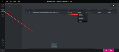

Maybe this helps?
‎2024-05-30 9:22 AM
Thank you, that's what I need.
