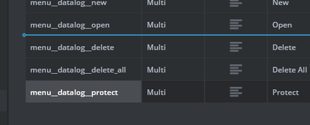

Dear GFX Team,
When trying to move(drag and drop) an item within a group

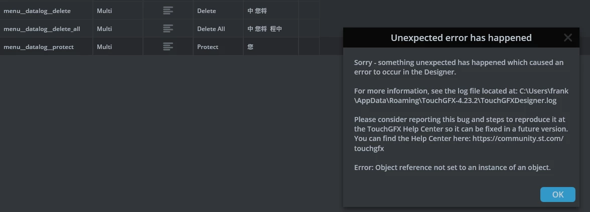

... This error message appears:
Error log:
2024-05-22 12:27:27,316 [1] ERROR TouchGFXDesigner.App: Object reference not set to an instance of an object.
System.NullReferenceException: Object reference not set to an instance of an object.
 at TouchGFXDomainModel.Texts.TextDatabase.MoveTextToGroupBefore(Text textToMove, Text beforeText, TextGroup textGroupTo)
 at TouchGFXDesigner.Main.Project.Texts.TextTab.TextGrid.TextGridViewModel.MoveText(Text sourceText, Text targetText, TextGroup targetGroup, RelativeInsertPosition relativeInsertPosition)
 at TouchGFXDesigner.Main.Project.Texts.TextTab.TextGrid.TextGridViewModel.Drop(IDropInfo dropInfo)
 at GongSolutions.Wpf.DragDrop.DragDrop.DropTargetOnDrop(Object sender, DragEventArgs e, EventType eventType)
 at GongSolutions.Wpf.DragDrop.DragDrop.DropTargetOnDrop(Object sender, DragEventArgs e)
 at System.Windows.RoutedEventArgs.InvokeHandler(Delegate handler, Object target)
 at System.Windows.EventRoute.InvokeHandlersImpl(Object source, RoutedEventArgs args, Boolean reRaised)
 at System.Windows.UIElement.RaiseEventImpl(DependencyObject sender, RoutedEventArgs args)
 at System.Windows.OleDropTarget.RaiseDragEvent(RoutedEvent dragEvent, Int32 dragDropKeyStates, Int32& effects, DependencyObject target, Point targetPoint)
 at System.Windows.OleDropTarget.MS.Win32.UnsafeNativeMethods.IOleDropTarget.OleDrop(Object data, Int32 dragDropKeyStates, Int64 point, Int32& effects)
 at MS.Win32.UnsafeNativeMethods.DoDragDrop(IDataObject dataObject, IOleDropSource dropSource, Int32 allowedEffects, Int32[] finalEffect)
 at System.Windows.OleServicesContext.OleDoDragDrop(IDataObject dataObject, IOleDropSource dropSource, Int32 allowedEffects, Int32[] finalEffect)
 at System.Windows.DragDrop.OleDoDragDrop(DependencyObject dragSource, DataObject dataObject, DragDropEffects allowedEffects)
 at System.Windows.DragDrop.DoDragDrop(DependencyObject dragSource, Object data, DragDropEffects allowedEffects)
 at GongSolutions.Wpf.DragDrop.DragDrop.DoDragSourceMove(Object sender, Func`2 getPosition)
 at System.Windows.UIElement.RaiseTrustedEvent(RoutedEventArgs args)
 at System.Windows.Input.InputManager.ProcessStagingArea()
 at System.Windows.Input.InputProviderSite.ReportInput(InputReport inputReport)
 at System.Windows.Interop.HwndMouseInputProvider.ReportInput(IntPtr hwnd, InputMode mode, Int32 timestamp, RawMouseActions actions, Int32 x, Int32 y, Int32 wheel)
 at System.Windows.Interop.HwndMouseInputProvider.FilterMessage(IntPtr hwnd, WindowMessage msg, IntPtr wParam, IntPtr lParam, Boolean& handled)
 at System.Windows.Interop.HwndSource.InputFilterMessage(IntPtr hwnd, Int32 msg, IntPtr wParam, IntPtr lParam, Boolean& handled)
 at MS.Win32.HwndWrapper.WndProc(IntPtr hwnd, Int32 msg, IntPtr wParam, IntPtr lParam, Boolean& handled)
 at MS.Win32.HwndSubclass.DispatcherCallbackOperation(Object o)
 at System.Windows.Threading.ExceptionWrapper.InternalRealCall(Delegate callback, Object args, Int32 numArgs)
 at System.Windows.Threading.ExceptionWrapper.TryCatchWhen(Object source, Delegate callback, Object args, Int32 numArgs, Delegate catchHandler)
