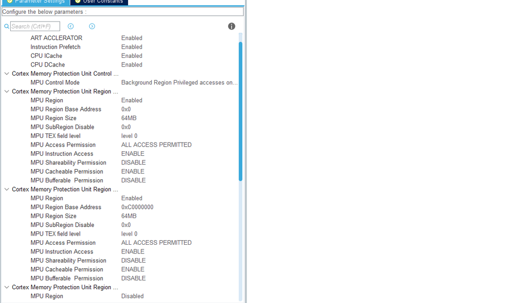

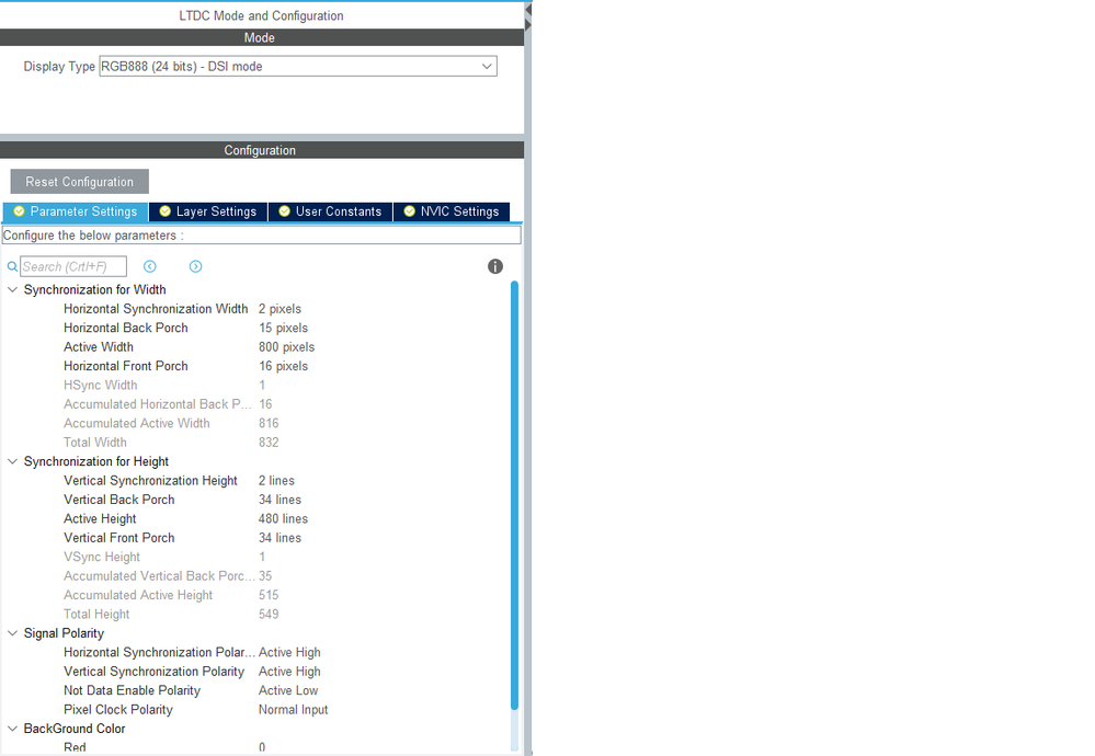

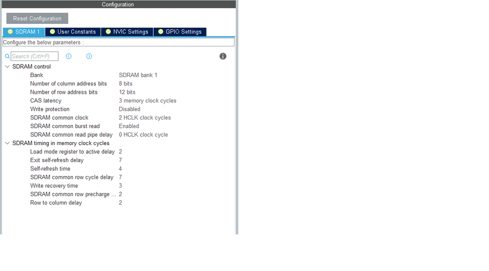

Hi everyone! I'm trying to create a project using CubeIDE 1.3, Touchgfx 4.13 and f769i-disco board. I have started building project with Cube and then added touchgfx using "additional software" menu. I have succesfully configured external SDRAM and display driver: I can see data being put into a buffer by touchgfx, but the screen shows nothing but a white stripe in the middle. I have tried copying parameters for ltdc and dsi from example but it still doesn't work.
So the question is: has anyone managed to configure the screen on this board properly without just copying BSP functions?

So i finally launched the application
Enabling MPU cacheable permission for external flash solved the problem
