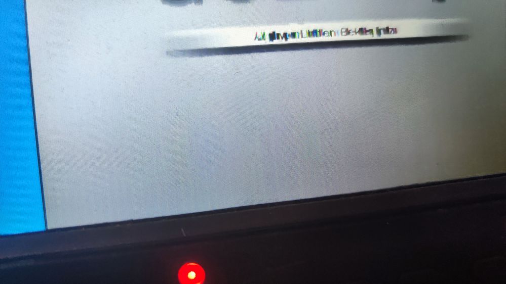

I was have an issue with screen that corrupted image on it. You can see below some example at picture.In expectation, the back color of the screen needs to be grey and the text need to be readable.

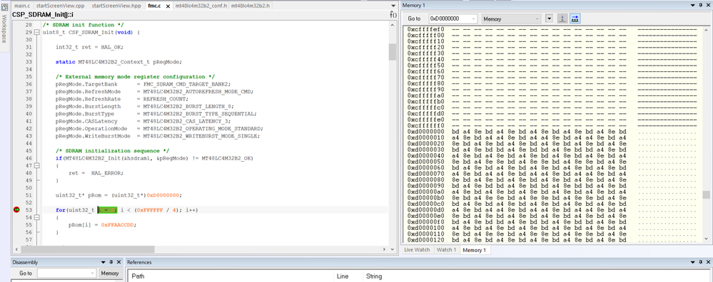

So I was start my own investigation on this issue. Right now, I have suspicion on external ram. I am try to use write a sngle word to external ram and see on debug mod. You can see two picture below for this test. You can see the ram status on right side of 1st picture.

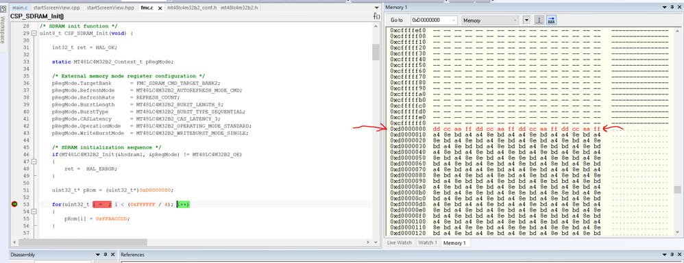

On second picture I just run code for 1 write operation. In my expextation fisrt 4 byte of ram will change to DD CC AA FF, the rest of it will be same. But you can see the ram status after fist write operation in next picture. Ram write same word for 4 time.

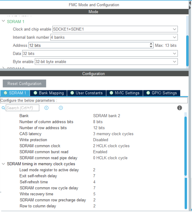

I am using ram BSP from ST examples. You can see installation of FMC at cube mx in below pictures.

Guess I found problem source. I just want to explain so that if any one have this problem like me.
I was use HAL library initialization function for FMC with BSP package that supplied for MT48LC ram that used on discovery kit. You can see BSP function at message that above. Example code was call BSP function after all HAL initialization functions in main.
I was using LTDC that take frame buffer from external ram. LTDC installation was finished before ram came online because of the BSP function location. Basically it was no harm because core will fix that issue probably. But I was have a custom board. I assume, this bad installation sequence create an electronic misbehavior and ram couldn't manage this issue.
Simply, I relocated the BSP function to the end of FMC installation function and its solve my problem.

You should be able to validate your SDRAM implementation irrespective of TouchGFX, and LTDC, etc.
Beyond that you'll also need to look at how the write-buffers, cache and write-thru relate to the coherency of what you've written vs what the DMA operation can sweep out of memory.
