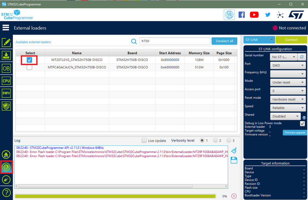

The method suggested in this thread only applies to "custom" external loaders, here you are using an ST development kit that has its dedicated external loader already included in STM32CubeProgrammer so it must be another issue.
Have you selected the proper one in the "EL" tab ?
Best regards,
Nicolas
‎2022-07-27 12:32 AM
Great, thanks!
I am new to this tool and did not choose external loader. It works now.

I'm working with a custom board with STM32H7A.
The custom external loader works properly from CLI, but cubeProgrammer fails to erase/flash/read external memory.
But if...
-Open CubeProgrammer.
-Click "Connect"
-After connected, go to "EL" and select your external loader file.
-Click the pencil icon and enter the address for your external Flash (0x90000000)
-Cubeprogrammer will work ok.
