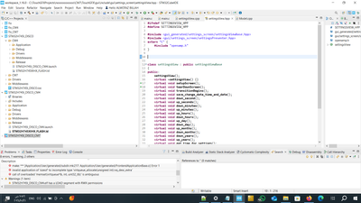

I have an STM32H745 Kit with two processors: M7 and M4.
I created graphics using TouchGFX and built several screens.
I set up the M4 to work with the RTC, and I want to send information from the M4 to the M7 using OpenAMP.
I modified the linker file and built the M4 file.
The issue occurred when I tried to integrate OpenAMP into the HPP and CPP files for each screen. Errors appeared, and I don't know how to deal with them.

10:55:13 Build Failed. 14 errors, 0 warnings. (took 3s.161ms)
call of overloaded 'memset(virtqueue*&, int, uint32_t&)' is ambiguous
invalid application of 'sizeof' to incomplete type 'virtqueue_allocate(unsigned int)::vq_desc_extra'
make: *** [Application/User/generated/subdir.mk:217: Application/User/generated/FrontendApplicationBase.o] Error 1
make: *** [Application/User/gui/subdir.mk:58: Application/User/gui/settingsPresenter.o] Error 1
make: *** [Application/User/gui/subdir.mk:60: Application/User/gui/settingsView.o] Error 1
make: *** [Application/User/TouchGFX/target/generated/subdir.mk:37: Application/User/TouchGFX/target/generated/TouchGFXConfiguration.o] Error 1
make: *** [Application/User/TouchGFX/target/generated/subdir.mk:39: Application/User/TouchGFX/target/generated/TouchGFXGeneratedHAL.o] Error 1
make: *** Waiting for unfinished jobs....
STM32H745I_DISCO_CM4.elf has a LOAD segment with RWX permissions
candidate: 'void* memset(void*, int, size_t)'
candidate: 'void touchgfx::memset(void*, uint8_t, uint32_t)'
Hello @motaz9898,
When you want to communicate with the backend of your GUI, you cannot directly add the codes to your screen files. Please follow the documentations below to learn about the procedure you have to take:
MVP Architecture
Concept of Screen
Backend Communication
I hope this helps you!

Should I use RTOS with OpenAMP?
And how can I open multiple communication channels?"
"When I tried to use OpenAMP alone in a C file, the processor hangs."
You can use it in two forms: with and without RTOS:
See these examples:
https://github.com/STMicroelectronics/STM32CubeH7/tree/master/Projects/STM32H747I-EVAL/Applications/OpenAMP
And that depends if you are using TouchGFX with RTOS, in that case you need to use OpenAMP with RTOS.
PS: This is NOT an online support (https://ols.st.com) but a collaborative space. So please be polite in your reply. Otherwise, it will be reported as inappropriate and you will be permanently blacklisted from my help/support.
