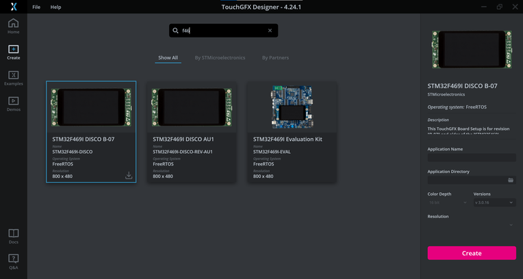

Hello @GMeta.1,
You need the latest versions of STM32CubeMX and STM32CubeIDE to ensure the best compatibility between your project files. When you use TouchGFX 4.24.1, the generated files for a TouchGFX Board Setup (TBS) are also based on the latest version of STM32CubeMX since TouchGFX and STM32CubeMX are tightly coupled.
To be honest, I am a bit confused by your statement that you are using TouchGFX in your project without an .ioc file. I assume you already have a project in TouchGFX 4.19.1 and you want to upgrade it to 4.24.1.
First, create a backup of your old project, then right-click on the .touchgfx file and open it with TouchGFX 4.24.1.
Then, open a new instance of TouchGFX 4.24.1, select the platform that you are developing on (for instance, STM32F469I Disco), and create a project:
STM32F469I Disco TBS

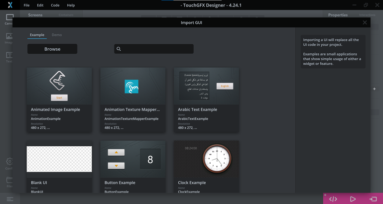

After that, click on Edit -> Import -> GUI. In the new opened window, click Browse and look for the project you converted to TouchGFX 4.24.1:
Import GUI
Now, you have your GUI in TouchGFX 4.24.1, and you should be able to run the simulator with no issues.
It is worth mentioning that you need to reapply the settings and custom code you have for the hardware parts (code related to the main.c file, UART connections, etc.)
I hope this helps you!
