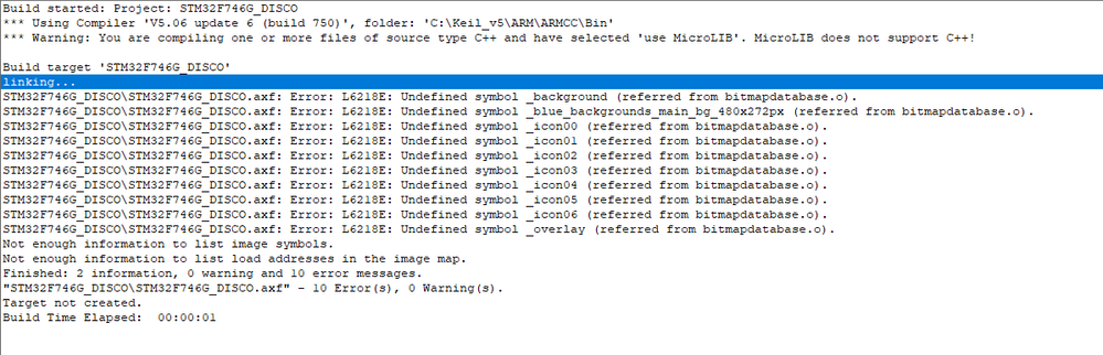

I have same problem with MDK-ARM (Keilc)
i have follow your recommend, but it not solve
My project have a image and some button with purpose to test TouchGFX 4.13 running with CubeMX 5.5.
How can i solve this problem.
‎2020-05-06 6:42 AM
I also had this.
In TouchGFX designer where the image files are listed, I also needed to explicitly set each image to 'InitFlashSection'. By default it was grayed out.
As pointed out, set CubeMX Project Manager->CodeGenerator" to IAR and regenerate.
Hope this gets others up and running too..
