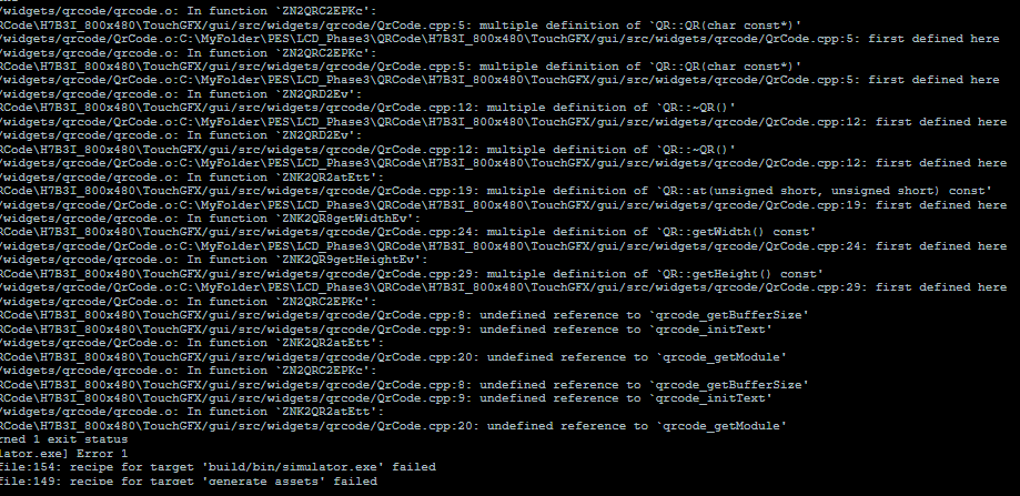

I am trying it out. I included qrcode.c and qrcode.h from the https://github.com/ricmoo/QRCode library, and your QrCode.cpp, QrCode.hpp, QRCodeWidget.cpp and QRCodeWidget.hpp in my TouchGFX environment. I get below error. Am I missing any other files? Please advice.
2022-11-15 1:00 PM
Where did you place .h and .hpp files? Are they in project paths? Are .c and .cpp included in project?
These are regular compiler errors - check your project settings...
2022-11-16 6:41 AM
I first put source and includes at TouchGFX\gui\src\widget\qrcode and TouchGFX\gui\include\gui\widget\qrcode respectively. That seems to be one folder level deep than necessary. So I moved to TouchGFX\gui\src\qrcode and TouchGFX\gui\include\gui\qrcode. Now TouchGFX sees them and tries to compile them when I click run simulator button.
Is this how you placed too? how did you tell TouchGFX to treat qrcode.c as a C file and not C++?
