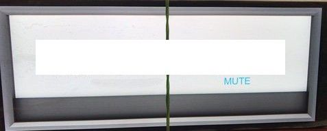

i use CubeMX and touchGFX generated code with custom DSI 480x1280 display.
All code works ok , but sometimes display is shifted horizontaly.
70% starts code on and display is pixel 0 to 479 ok.
But 30% starts dispolay randomly shifted and show 60-479-0-59 and rgb is too shifted randomly to gbr or brg. 60 is too random between 30 - 150
I need idea howto solve this.
We use FMC SDRAM and seems as LTDC DSI sync data problem.
Pls help. I attach hwinit cpp file. MCU in main is started and go to sleep
HAL_PWR_EnterSTOPMode(PWR_LOWPOWERREGULATOR_ON, PWR_STOPENTRY_WFI);
then wake up by button and go. Code work all ok only GUI is sometimes shifted.

I have news and images,
maybe anybody have same issue.
Same code turened ON ok.
Same code next turn ON bad
I check memory and data is ok in mem position. Too i place one test point to left down corner after init display before start touchGFX rtos
and point is showed always properly and shifted after touch graphics make first show from black disp with only one point in corner.
Then i add to one button control code to start HAL_DSI_PatternGeneratorStart(&hdsi, 0, 0); Next press stop and miracle bad is corrected to ok.
Please help?

TTulw.1
I have the same problem. The whole screen is shifted to the right by random amount of pixels. It only happens when I reset the device with taking power off or reset pin.
When I software reset after reprograming the shift never occurs. I use TouchGFX 4.15.
I've tried many porch, sync and pixel clock settings.
Reseting the peripherals (ram, LCD, QSPI) doesn't solve the shift.
I now use workaround with twice call
if (HAL_DSI_ConfigVideoMode(&hdsi, &VidCfg) != HAL_OK)
  Error_Handler();
one on init dsi and second after around 500ms later.
But still i see very undocumented startup DSI on STM32.

I tried changing the HorizontalSyncActive parameter and it worked!
I just divided the calculated value by 2:
 hdsivideo_handle.HorizontalSyncActive   = (HSA * laneByteClk_kHz) / LcdClock / 2;
It seems that the sync pulse wasn't recognised, changing it to smaller value worked. Can someone clarify what are exact formulas to calculate those parameters ?
