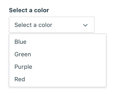

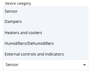

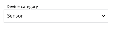

I create drop-down used by slide menu but it isn't working how I want.
0693W00000WIOJkQAP.pngWhen I click this dropdown it expands and background image goes to last position, like this :0693W00000WIOKOQA5.pngI want that my background picture be in first position like that:
0693W00000WIOKnQAP.pngHow can I achieve it? Thanks.

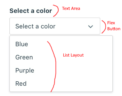

Late comment but maybe you could just have it divided into three things (based on the last picture):
  • text area
  • flex button (with text, box with a thin border, and the arrow icon)
  • list layout (have a look at the list layout example, no need to implement it in a scrollable container though. You make it visible or scroll it when you press the flex button. To do the scroll effect I would personally put the list layout in a container which you gradually change the size to make the elements visible and invisible. I can elaborate if you want if the solution suits you)
