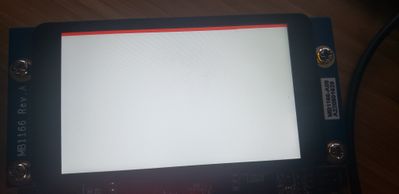

I used STM32CubeIDE to create the LCD_DSI_CmdMode_DoubleBuffer for the STM32F769I-DISCOVERY board. It works fine, but I made some modifications to just draw a rectangle:

 However the red rectangle is only partially drawn (it's supposed to take up half the screen):
If I put a HAL_Delay before the refresh, it draws the whole rectangle. This suggests the DMA2D isn't finishing the transfer to the framebuffer even though it says it is (HAL_DMA2D_PollForTransfer() is returning in LL_FillBuffer()), but I'm really not sure as I'm pretty new to this stuff.

Turns out if I add a delay right after turning on the display, it works fine:
  /* Send Display On DCS Command to display */
  HAL_DSI_ShortWrite(&(hdsi_discovery),
                     0,
                     DSI_DCS_SHORT_PKT_WRITE_P1,
                     OTM8009A_CMD_DISPON,
                     0x00);
  HAL_Delay(1);
  BSP_LCD_SetTextColor(LCD_COLOR_BLUE);
  BSP_LCD_FillRect(0, 0, 800, 240);
  /* Refresh the LCD display*/
  HAL_DSI_Refresh(&hdsi_discovery);
 My guess is that there's an issue with the refresh occurring so soon after turning on the display.
