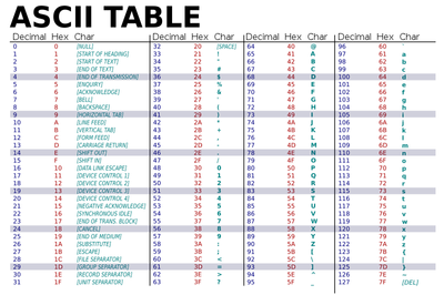

Apparently this is just a character converter. It doesn't seem to be applicable to different languages.
Binary Translator Convert Binary code to Text (English or ASCII) and vice versa
800px-ASCII-Table-wide.svg
Try searching for some Google translator online API.
