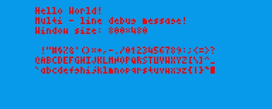

2019-12-09 12:51 AM
Here's an example:
Here's the important code. This is just using a simulator.
int CALLBACK WinMain(HINSTANCE hInstance, HINSTANCE hPrevInstance, LPSTR lpCmdLine, int nCmdShow)
LCD24DebugPrinter lcd24bppDebugPrinter;
char allchars[256];
int ix = 0;
for (int i = 32; i < 128; i++)
allchars[ix++] = i;
if (i % 32 == 31)
allchars[ix++] = '\n';
allchars[ix] = 0;
char buf[300];
snprintf(buf, sizeof(buf), "Hello World!\nMulti - line debug message!\nWindow size: %d*%d\n\n%s", SIM_WIDTH, SIM_HEIGHT, allchars);
// Create hardware layer. Display size is defined in SimConstants.hpp
// Martin: Important to init HAL before using Color class
HAL& hal = touchgfx_generic_init<HALSDL2>(dma, lcd, tc, SIM_WIDTH, SIM_HEIGHT, 0, 0);
// Simulate hardware running at 60Hz generating a vsync every 16.6667 ms
static_cast<HALSDL2&>(hal).setVsyncInterval(16.6667f);
static_cast<HALSDL2&>(hal).setWindowTitle(SIM_TITLE);
//Configure debug printer
lcd24bppDebugPrinter.setPosition(50, 10, SIM_WIDTH - 60, SIM_HEIGHT - 30);
lcd24bppDebugPrinter.setColor(Color::getColorFrom24BitRGB(255, 0, 0));
lcd24bppDebugPrinter.setScale(2);
//Set printer object and debug string
Application::setDebugPrinter(&lcd24bppDebugPrinter);
Application::setDebugString(buf);
