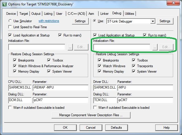

0693W000008GZkDQAW.jpgMemory, Peripherals, Variables, Watches, etc anything that touches the 4GB address space of the processor

And here is the QSPI configuration in main. c? Sorry, did you read the topic carefully? The error occurs during code loading, before it is run. At the moment when, for some unknown reason, the memory is accessed, it is the memory and should not be initialized. The question is not why it is not initialized, the question is why it is accessed before initialization.
The H7 is significantly more complex, that things works on the F7 is practically irrelevant to solving the problem here.
All instances here it is failing at the download/debug stage not the build stage.
Salient things to post would be the .AXF file, .MAP file, and the .UVOPTX file
What version of Keil MDK is being used? 5.33 is current
What STM32H7 pack is installed?
What version of CubeMX is being used? 6.1.1 is current
Focus on what's physically failing. All the signs point to QSPI, whether its the lack of a loader, or the debugger touching the memory.
