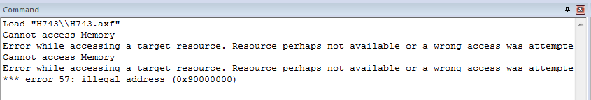

Than I edit project in TouchGFX editor, add one button, generate code, and build it in KEIL.
Than I download it to flash.
Then starting debug I get error, on this stage
this error

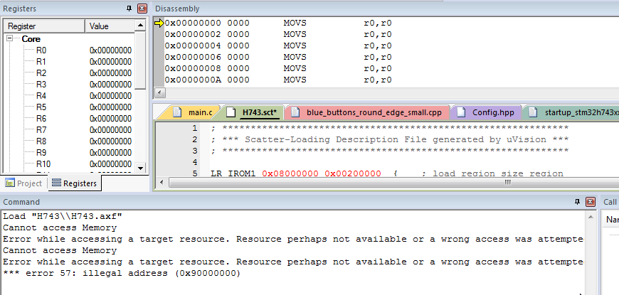

I accidentally saw it - after generating an error, the "command" window appears for a very short moment, indicating the error. Then this window disappears, caught only through the screenshot.
‎2021-02-16 8:08 AM
‎2021-02-16 8:16 AM
From where is here 0x90000000 ?

‎2021-02-16 8:21 AM
"From where is here 0x90000000 ?"
From here
Notionally in the command window it would be from a) Memory Views previously selected, b) Accesses in the Debug Script (.ini) associated with the project.
The failure would occur at the point where the STM32H7 is initially brought up, but the external memory interfaces haven't been instantiated by the code, or debug scripting walking the RCC, GPIO, QSPI, etc through the initialization sequences manually.
‎2021-02-16 8:59 AM
" b) Accesses in the Debug Script (.ini) associated with the project."
Where it?
"a) Memory Views previously selected, " - you mean "Memory window?"
