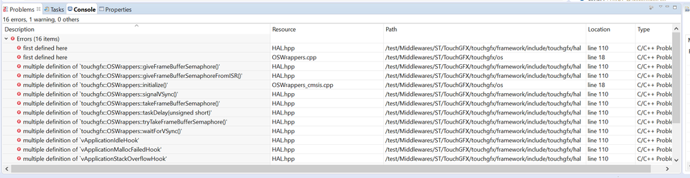

I started the project in CubeMX 5.1.0 from STM32F746DISCO board and it compiles ok, but when I add TouchGFX graphics TrueStudio always returns error when build.
The errors are similar like "undefined reference to `MX_FREERTOS_Init()" or "undefined reference to `typeinfo for touchgfx::DMA_Interface". But for example the function "MX_FREERTOS_Init()" is properly declared.

Finally I could compile!!!
Well the last problem in fact was really strange, because I found that the entire Middlewares' folder was set as "Exclude resource from build", but never before I set this, only for the simulator folder.
I don't know if CubeMX can modify this parameter... of course I needed to modify a lot the project created by CubeMX to reach success, but with this thing I waste a lot of time..

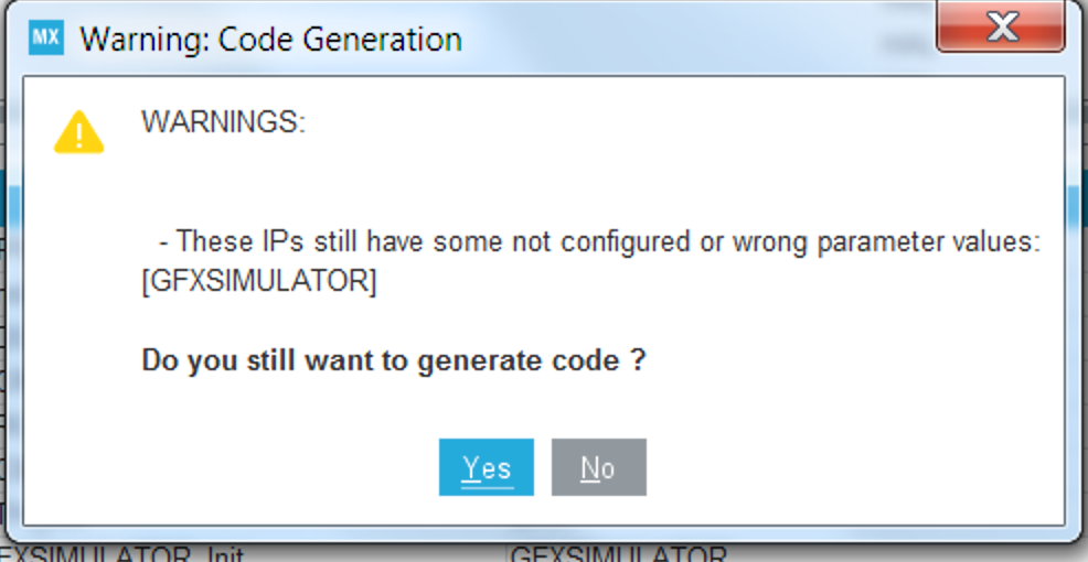

How do you get around this error?
This occurs when Generate Code within CubeMX 5.1.0

I am having similar problems.
Should there be a separate TouchGFX distribution which doesn't include the simulator stuff, for CubeMX use ?
I installed TouchGFX separately, first, and then CubeMX, but I'm having all these same problems.
and after removing the simulator and sdl stuff myself, I have different problems:
@Martin KJELDSEN​  disabling rtti did it for me, thanks!
