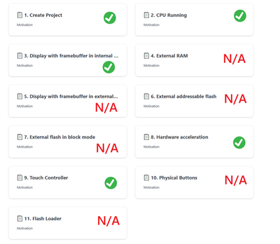

Some of the steps are not available for our set up such as external ram or external flash. But the important ones such as DMA2D and internal ram frame buffer work as expected.  See below for the detailed steps.

You lacks info. Image with checks is very basic, U5 with GPU is little harder.
Show your main code and MX_LTDC_Init etc... Good to if RTOS used show app_freertos.c
And about debug, you can as normal place breakpoint and ... Primary check if model.cpp func tick is entered...
