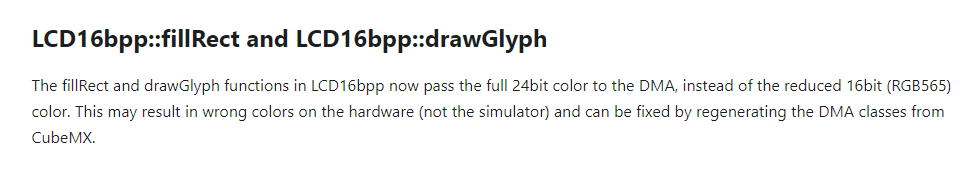

Critical bug: After update to 4.18.0 colors are incorrect on Hardware, but "Run Simulation" still works as expected
VSimu.1
Here an example from the hardware
but in Run Simulation:
0693W00000GXAyLQAX.pngWe are using
 touchgfx::TextAreaWithOneWildcard
and the colors are wrong when we do not use 255,255,255 and 0,0,0. Only these two colors work
We use the following colors, and it is causing problems. In Run Simulation, everything works as expected
These are the color codes we use

What MCU are you working with ? Could you try generating code from STM32CubeMX again ?
/Romain
VSimu.1
It seems this is a "known issue". For anybody else seeing this "issue"
https://support.touchgfx.com/4.18/docs/miscellaneous/known-issues

a) We were able to fix our issue by updating to the latest STM32F7DMA.cpp file
