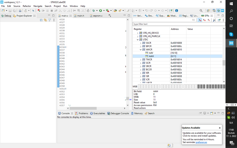

I've been trying to integrate a simple TouchGFX project into STM32CubeIDE (so that I can add my own code to it), it's supposed to print simple graphics on the screen of a STM32L4R9I-EVAL board, but I stumbled upon an issue in the LDTC initialization : I can't write the LTDC configuration in the correct registers. In HAL_LTDC_Init, the LTDC registers are supposed to be initialized with parameters (e.g. the display size goes in AWCR), but when monitoring them through the debugger's memory monitor at address 0x40016800, I only see zeros... Note that earlier it was all 0x2220, I have no idea why it changed. Also, I can see that other peripherals don't have this issue because there are non-zero bytes near address 0x40000000 (the start of memory-mapped peripherals).
I attach 3 screenshots at different points in the program's execution (using breakpoints), to show that the value of register AWCR does not change despite being written into. Plus 2 screenshots showing the memory monitor.

Your debug read reg attempt isnt real. xxxx->YYYY->ZZZZ debuger dont handle as access to reg.
Add SFR peripheral view to debuger and check LTDC real info

I didn't know this view, I checked but in the middle of LTDC initialization, all the LTDC registers are still at zero (see screenshot)...

waclawek.jan
> LTDCRST = 1 : LCD-TFT reset is on (not sure what it means)
You mean RCC_APB2RSTR.LTDCRST? It means exactly what you'd think: the LTDC module is held in reset. This is your problem.
Aksl
Alright, I found out it came from a line :
__HAL_RCC_LTDC_FORCE_RESET();
I remember adding it a few days ago, hoping it would trigger a reset of the LTDC, not hoping it would prevent it to load itself.
After removing it and re-running, I saw it does not change anything to the state of the LTDC registers (nor RCC). And if I stop the execution anytime later, I still see zero-valued registers.
