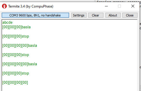

FLine.1
Finally
Yes this is because
HAL_UART_Transmit(&huart2, (uint8_t *)giden,10,30);
when you not need send binary zero then change line to
HAL_UART_Transmit(&huart2, (uint8_t *)giden,strlen(giden),30);
