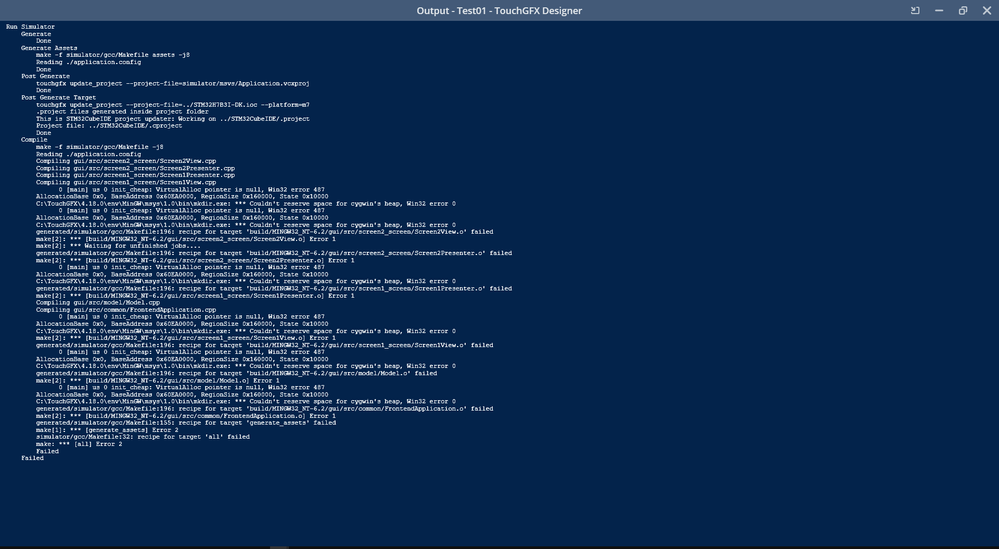

I always show this message when I compile.
I tried to reinstall the TouchGFX 4.18.0 many times but it always same happened.
I tried to run in Windows 11 and Windows 10, but it is not changed.
I tried after removing the MS visual studio, but nothing changed.
I have STM32H7B3I-DK.
But it is the same happened when I try to PC simulate.
It has passed 2 weeks since I bought this kit.
But I can't proceed anymore because of this error.
I need support to solve this problem.

0 [main] us 0 init_cheap: VirtualAlloc pointer is null, Win32 error 487
AllocationBase 0x0, BaseAddress 0x60EA0000, RegionSize 0x160000, State 0x10000
C:\TouchGFX\4.18.0\env\MinGW\msys\1.0\bin\mkdir.exe: *** Couldn't reserve space for cygwin's heap, Win32 error 0

‎2021-11-30 9:15 AM
In how directory is placed application, try short path without spaces for example c:/tproject/Myapp1
is on your disk free space,
try older version template if exist.
‎2021-11-30 9:17 AM
I tried it, but it is the same.
I remove the 4.18.0 and installed 4.17.0, it was the same.
I tried other paths, it was the same.
‎2021-12-01 11:32 AM
I solved this problem, but I have another problem again.
I found "rebase.exe" on the internet and copied it in the same folder with msys-1.0.dll.
And entered ".\rebase.exe -b 0x50000000 msys-1.0.dll".
It works now.

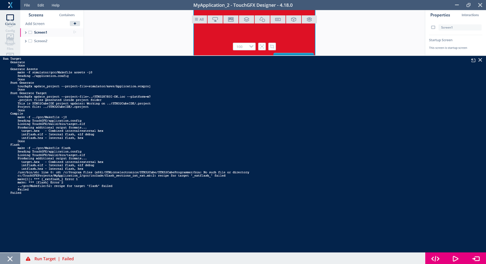

But I have another problem.
"Run Target" has an error now.​

/usr/bin/sh: line 0: cd: /c/Program Files (x86)/STMicroelectronics/STM32Cube/STM32CubeProgrammer/bin: No such file or directory
c:/TouchGFXProjects/MyApplication_2/gcc/include/flash_sections_int_ext.mk:2: recipe for target '_extflash_' failed
make[1]: *** [_extflash_] Error 1
make: *** [flash] Error 2
../gcc/Makefile:52: recipe for target 'flash' failed

‎2021-12-02 10:41 AM
@mattias norlander​ @Khouloud ZEMMELI​
What do you think? Msys or cygwin bug? Windows broken on user's machine?
> It works now.
‎2021-12-30 5:25 AM
Seems like a some what common cygwin issue...
‎2021-12-30 5:36 AM
Are you relying on cygwin to execute the "Flash" operation too?
If you are using cygwin then I guess that we cannot write this:
cd "/c/Program Files (x86)/STMicroelectronics/STM32Cube/STM32CubeProgrammer/bin"
Maybe the path need to also include "cygdrive/"? Like this:
cd "/cygdrive/c/Program Files (x86)/STMicroelectronics/STM32Cube/STM32CubeProgrammer/bin"
