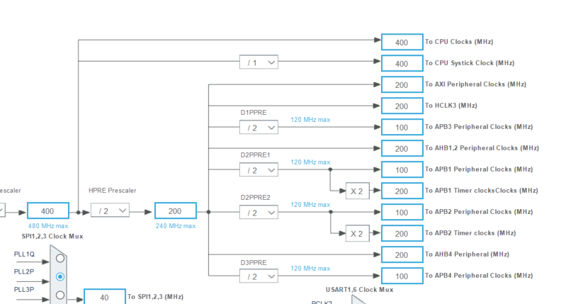

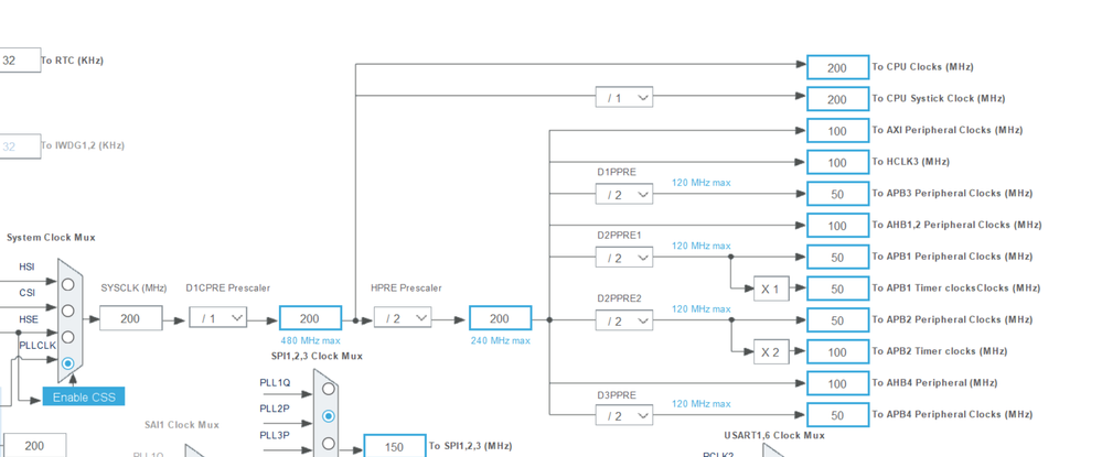

I am working on an existing project based on the STM32H750 where I want to stop overheating by reducing the CPU frequency.
Currently I use 400MHz and I want to lower it to 200MHz. I have peripherals (LCD and SPI flash) as well as timers (TIM1,2,5) that are affected by this change.
My question is which adaptions to the Timers and possibly the initialization of LCD, ext. flash I have to make when changing the CPU frequency? Is there a lower limit for the LCD bus frequency for example?
For the timers I adapted the prescalers but that doesn't do the job yet. (black LCD screen and crash)
My old clock config:
My new tentative clock config:

Why can't you simply drop the CPU/SYSCLK to 200 MHz, and leave the AHB and down stream APB's as they are?
>>> As stated in this file (here ) The maximum bus matrix frequency is half the maximum CPU frequency, I had it at 200MHz so now with 200MHz I am unable to keep it this high (also indicated by CubeMX).
Read it carefully - it tells only about the relation of both maximum frequencies. It doesn't require the ratio to always be 1:2.
>>> Ok. I found out that what happens is that when changing sysclk to 200MHz, the voltage range changes to 3. This implies a max frequency for AHB1,2 of 100MHz which means I have to reduce it.

I got it working by respecting the following:
  • When using the automatic prescaler determination by CubeMX various other freqeuncies for PLL1,2,3 get changed leading to SPI, I2C and other peripherals not working anymore.
  • Best way was to just tweak a single prescaler that sets the SYSCLK to 200MHz and adapt the rest to that the peripheral clocks stay the same.
  • Important was also to *not* use PWR_REGULATOR_VOLTAGE_SCALE3 automatically set by CubeMX and instead use PWR_REGULATOR_VOLTAGE_SCALE2 or 1
