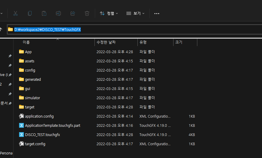

HJung.6
March 28, 2022
same problem.
how can i fix?
HJung.6
March 29, 2022
solve!
check "run as administrator" TouchGfx Designer"
