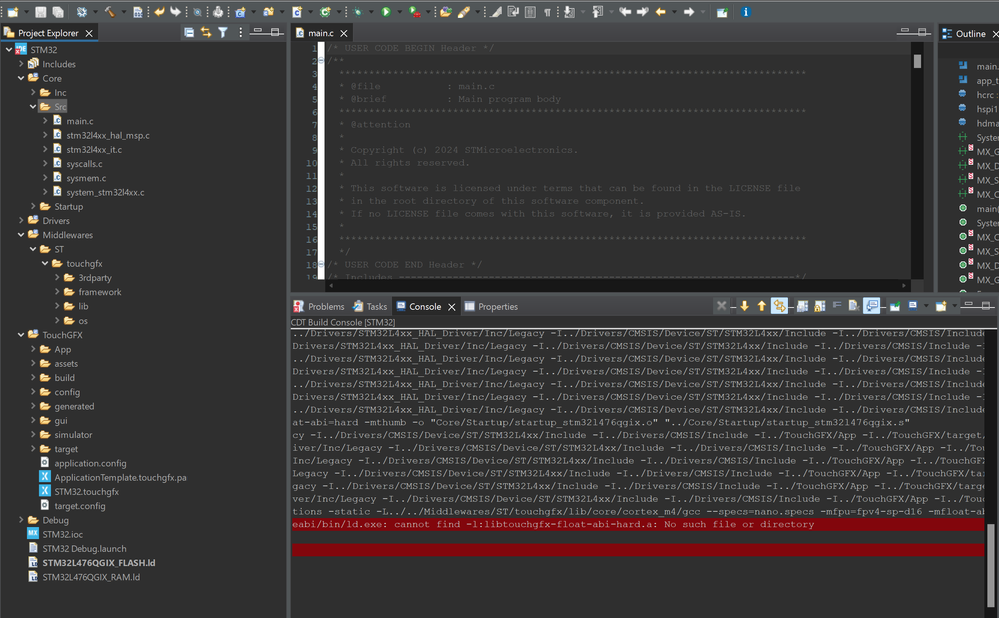

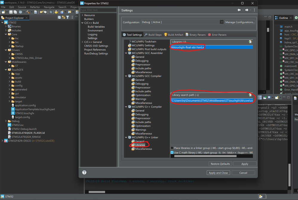

the first one (Libraries tab) should be the same as the picture (:libtouchgfx-float-abi-hard.a) while the second one (Library path) should be related to the microcontroller you are using (in your case an M4 based microcontroller so the path will be ../Middlewares/ST/touchgfx/lib/core/cortex_m4/gcc).
You can also generate as a reference one of the TouchGFX examples/demonstration of the same microcontroller family you are using and check what it is automatically set on those tabs.
Best regards
Thank you so much for your giving me the response.
I tried this but now I'm getting another error which is related to path of Libararies tab.
I've tried generating an example project and the correct library path is:
../Middlewares/ST/touchgfx/lib/core/cortex_m4f/gcc
As you can see in the folders that TouchGFX designer has generated after the "Code generation" process.

It worked after I added the path and library name in Properties->C/C++ Build->Settings->MCU/MPU G++ Linker->Libraries.
Thank you so much for the help Man!!!
