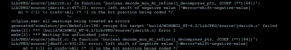

GFX's designer tell me that all warnings would be treated as errors.
But it's part of the LibJPG library, and I can't change it.
Is there any way to get rid of this "error"?
​I want to open a JPG image in the simulator and display it

Designer uses the makefile located in your application at simulator/gcc/Makefile.
You'll find a list of compiler flags here. Remove "error" to not treat warnings as errors.
WARN = error all extra write-strings init-self cast-qual \
       pointer-arith strict-aliasing format=2 uninitialized \
       missing-declarations no-long-long no-unused-parameter \
       no-variadic-macros no-format-extra-args \
       no-conversion no-overloaded-virtual

Thank you very much for your kind help.
