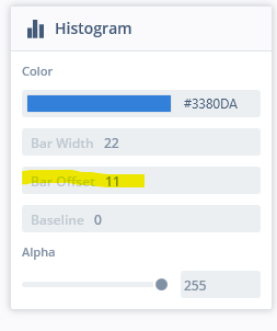

I use a static graph in my project, but after some time (adding other stuff) the TouchGFX-Designer (4.20) creates incomplete code:
This happend several times, only fix is to remove and add a new diagram.
This is the generated code:
0693W00000WIVwyQAH.pngThis is how it should be looking:
0693W00000WIVxSQAX.pngFurthermore, the Bar-Offset from Histogram, never appears in the generated Base Class.

If you want to access the bar offset parameter from your code, you can the setBarOffset() or getBarOffset() functions from this class.

Hello Yoann,
sorry I'm not sure when this happens, coundn't find a way to reproduce it, but it happend several times.
I have three custom containers, each with a different Histogram, if this bug occur, the code is missing on all three of them. A new code generation doesn't help.
But I'll keep watching!
The setBarOffset() works well, if I add it manually, but it would be better if the Designer would do this for me ;)

The Histogram Bar Offset do not appear in the generated code for me neither.
I add it manually in my code.
Color, Bar Width, and Baseline code is generated as expect.
TouchGFX 4.21.1
