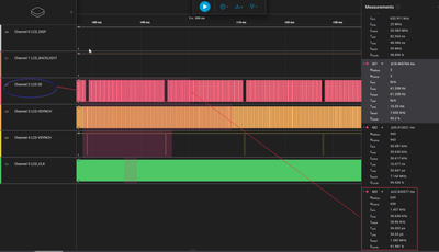

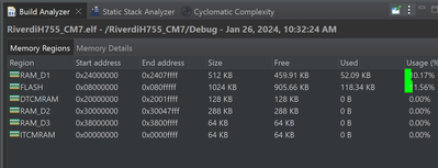

Based on this image what should have been the proper framebuffer Starting address for the board?

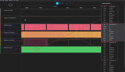

trying to check the pins:
