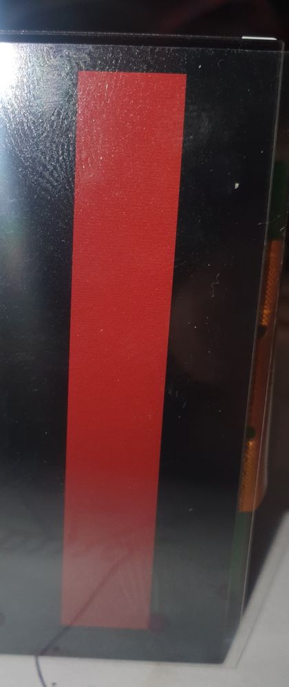

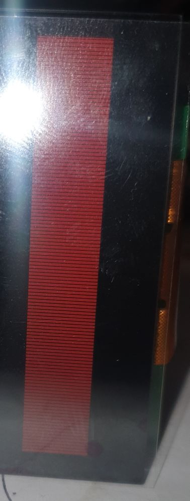

Black horizontal lines when SDRAM is used. Why?
Exit0815
Senior
another day, another problem...
I just started with a custom board. But i am using parts which are already working on boards from ST so i thought it will be easy to adapt.
I started a new project and if i use internal RAM for a touchgfx box everything is fine.
As soon as i add the SDRAM to the linker file i have a lot of lines (black or just not read from sdram correctly?).
For SDRAM the MT48LC4M32B2 with 16MB is used like in a lot of disco or eval boards.
MCU is running at 200MHz

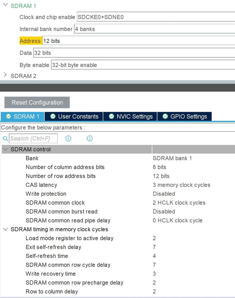

My FMC / SDRAM Settings:

Here are the SDRAM Settings in MX and the pictures of the display with and without SDRAM active.
What did i forget?
Can it be a not proper soldered connection? Should this not end in a hardfault?
Thanks a lot for helping.

OK, this happens when not every connection between MCU and Flash is connected.
Reworked PCB and it works now.
In the unlikely event someone else has the same problem, check the connections

Thanks for your answer.
I changed Data and Byte endable to 16 bit instead of 32 and now it is working.
But i expect a lower performance, right?

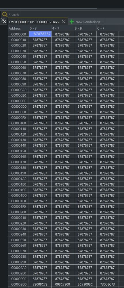

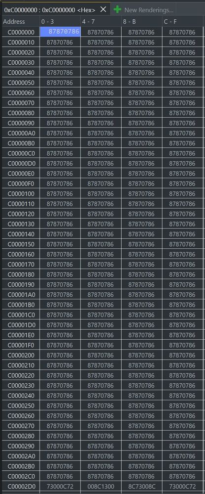

So i just found some time and i checked the 0xC0000000 just quick with the memory function in debug mode.
Am i right that the values should be the same one, if 32Bit or 16Bit?
Then there is a difference and something is wrong.
I am not sure if all pins are 100% connected from MCU to the SDRAM.
Does that look like it could be wiring issue or is it a setting problem?
The only change i did is the "Data" and "Byte enable" from 16 Bit to 32 Bit in CubeMX.
