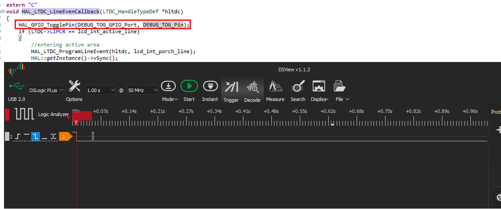

Back with available logic analyzer...
Do you see the LTDC interrupt getting fired: LTDC_IRQHandler -> HAL_LTDC_LineEvenCallback()?
It enters only 2 times
  And codes stucks at:
I would look into the LTDC and DMA2D registers and see if something is wrong.
Another possible cause: GUI task stack size but it is hard to tell if this is your case.
I don't think you would need that as you are running your code from the internal flash and your linker command by default uses STM32F746NGHX_FLASH.ld

 I am afraid that with a display 800x480 you would need a 32-bit
  hsdram1.Init.MemoryDataWidth = FMC_SDRAM_MEM_BUS_WIDTH_16;
You can dump the LTDC/DMA2D registers to tell what's going on.
You can as well slow down the pixel clock to the lowest possible value. Not sure what the actual value is.
AN4861 table 12 says that with SVGA and 24bit you would need 32-bit SDRAM:
https://www.st.com/resource/en/application_note/dm00287603-lcdtft-display-controller-ltdc-on-stm32-mcus-stmicroelectronics.pdf

Thank you Badreddine,
16bpp might be enough for our application.
Adding a 32-bit SDRAM is not a choice cause we will need to re-design the whole PCB (with 16bit SDRAM and only 4 pins left free).
Thank you all.
