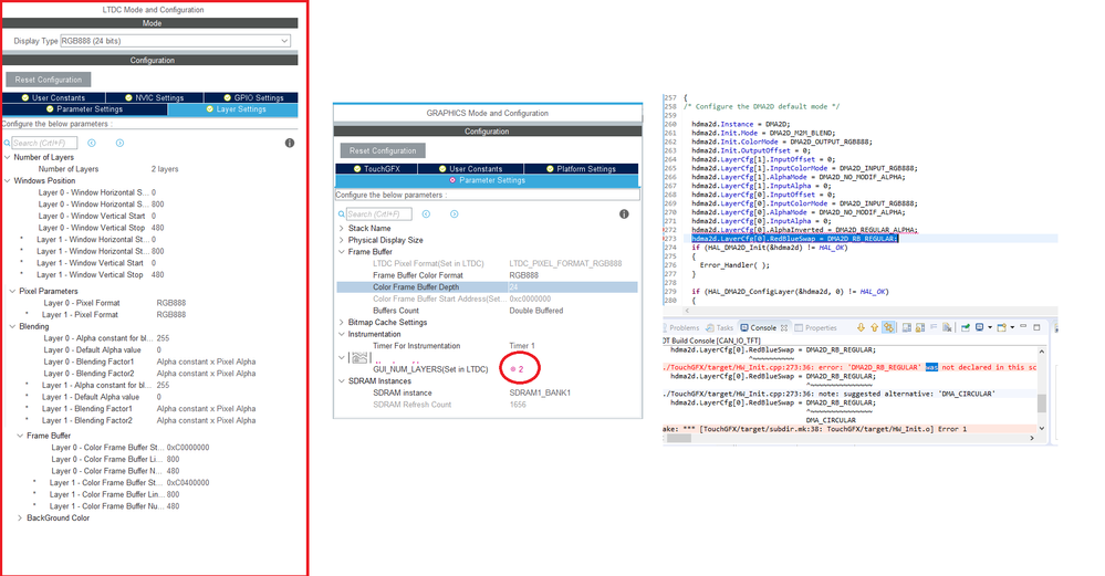

i used the STM32CubeIDE Version: 1.1.0 with TouchGFX designer 4.12.3 to build a project for the F746G-Disco. Everything worked fine, i was able to display animations etc.
Then, i made the changes to my custom board (based on Disco schematics) to use a 5 Inches (800x480) TFT and i was able to display some boxes/images but when i tried to display some animated images, the animation was not working (seems frozen).
The Touch panel is not configured yet, due to different driver than Disco.
Could this be a hardware issue? I am attaching the screen datasheet and the project, in case someone could help.

it should be related to the amount of framebuffers you're using. tGFX allows you to use 1,2 or 3. the 3rd is also called 'animation storage' so enabling that might help you a bit.
First I would make sure that your RAM is actually working - one can never be too sure ;)
when you have verified that it works you should have a look at the linker scrips and verify that you are using the external RAM for storage.
Then you can look into the amount of buffers you assign to the project. The 746-Disco can do all 3 buffers using the SDRAM so you should be able to do that as well.
I am not able to enable the 2nd framebuffer.

Layers are not the same as framebuffers
With that said, you need to find the following:
setFrameBufferStartAddresses((void*)frameBuf, (void*)(frameBuf + sizeof(frameBuf)/(sizeof(uint32_t)*2)), (void*)0);
In my project it is located in:
/STM32H7B3I_DISCO/Application/User/TouchGFX/target/generated/TouchGFXGeneratedHAL.cpp
the method takes 3 arguments:
     * @fn virtual void HAL::setFrameBufferStartAddresses(void* frameBuffer, void* doubleBuffer, void* animationStorage)
     * @brief Sets frame buffer start addresses.
     *        Sets individual frame buffer start addresses.
     * @param [in] frameBuffer      Buffer for frame buffer data, must be non-null.
     * @param [in] doubleBuffer     If non-null, buffer for double buffer data. If null double buffering is disabled.
     * @param [in] animationStorage If non-null, the animation storage. If null animation storage is disabled.
so you'd want to add the adress of the animation storage instead of the (void*)0 in the last argument. you can calculate the address the same way the second framebuffer is calculated.
On TouchGFX\target\BoardConfiguration.cpp i added:
static uint32_t frameBuf0 = (uint32_t)(0xc0000000);
static uint32_t frameBuf1 = (uint32_t)(0xc0400000); // Added
static uint32_t frameBuf2 = (uint32_t)(0xc0800000); // Added
void touchgfx_init()
  uint16_t dispWidth = 800;
  uint16_t dispHeight = 480;
    HAL& hal = touchgfx_generic_init<STM32F7HAL>(dma, display, tc, dispWidth, dispHeight,(uint16_t*) 0,
                                               0, 0);
    /*hal.setFrameBufferStartAddress((uint16_t*)frameBuf0, bitdepth ,true , true);*/
    hal.setFrameBufferStartAddresses((uint16_t*)frameBuf0, (uint16_t*)frameBuf1 , (uint16_t*)frameBuf2); // Added
Still the same issue
how do you calculate the address for the frameBuf1 and 2?
I saw the 0xC0400000 address from the Cube when i tried to define second Layer..
Based on the calculations i tried, 800*480*3 = 0x‭00119400‬ so the frameBuf1 should be on 0x‭C0119400‬ and the frameBuf2 on ‭0xC0232800‬?
Tried it too without success
